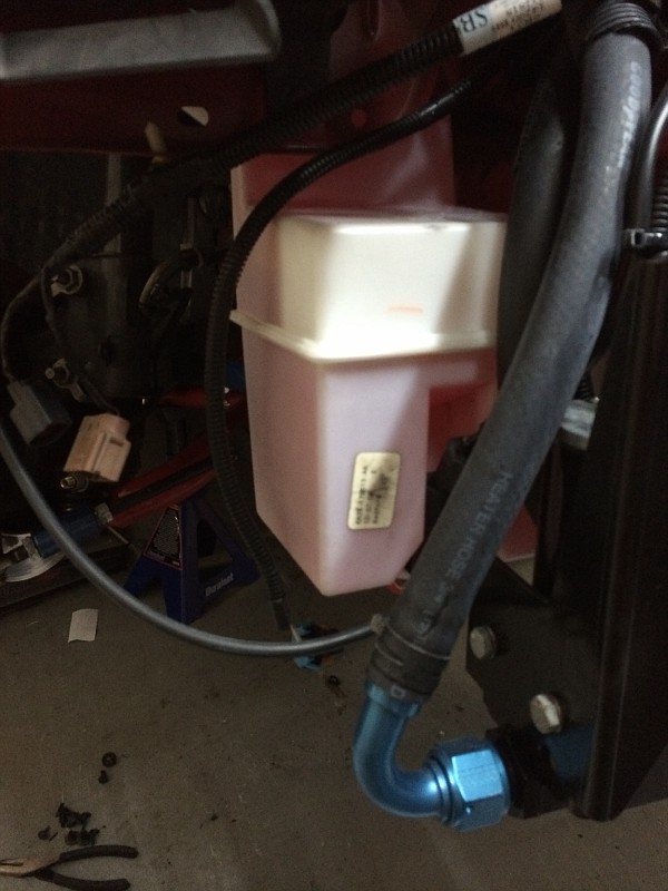

I then re-installed the windshield washer reservoir and ran allt he lines, loomed the wires, and installed the controller:
