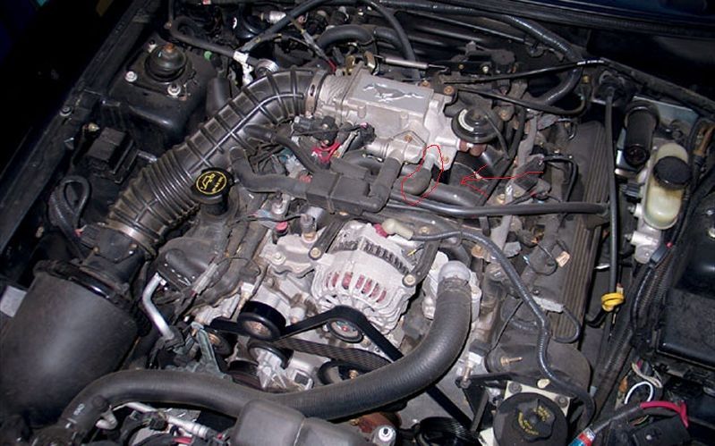

Does anyone know where you can get the hose that goes from the pcv valve on the valve cover to the port on the plenum? There is a plastic tube in between the pcv and the plenum that leads into the hose that I need. (The hose is a different inside diameter on each end and a few inches long.)
Backstory: When I changed to an accufab throttle body and plenum, the stock hose was all dry rotted and broke when I tried to remove it. I tried getting one from the help aisle at the parts store help aisle but the only one that they had that would work isn't rigid enough and collapses when the car is running and after a few months of being fine, it started making this horrible loud vacuum noise at idle. The guy at the desk didn't know anything of course and said that they didn't have anything else that would work. Tried another parts store, and same problem. Tried looking online but didn't find anything there either....
The accufab plenum that I bought used seems to have a bigger port them my factory one did as well which also complicates the problem further bc I don't know if a new factory one would work either? Has anyone else ran into this?
Here's a pic for reference: I circled the hose in red. Not my car but you get the idea.

OEM from Ford dealership, they may upcharge for it but i doubt home depot or an auto store would have a hose with different I.D.'s.... thats not the PCV valve. pcv valve is coming off the driver side valve cover... idk what you meant by that.

This is similar to what goes into my passenger side valve cover. (I actually already tried this kit but the hose is not even close to expanding enough to go on the plenum.) Is that not a pcv valve on the end though?
#14 ·
No that is for a 99-01 what you need is the one I posted that is the one that goes from the plenum to the pass side valve cover
And don't use radiator hose or any soft hose they fail in 10 min because of the heat
And I wouldn't suggest breathers eather but that's another route you can go

I actually already have the plastic piece. I need a short rubber angled piece that goes from that plastic piece and connects to the plenum. The original one was dry rotted on my car and fell apart. I ordered this kit from late model restoration and the hose diameter was way to small. I think I need one for 01-04 mustangs since this plenum outlet is much bigger than the original plenum and I heard they are different from 96-00 vs 01-04. May try this one that someone posted earlier. I hate to waste another 30 bucks on something that may not work though. http://www.latemodelrestoration.com...ion.com/item/LRS-6664B/2001-04-Mustang-46L-2V-Gt-Pcv-Valve-To-Upper-Intake-Hose
