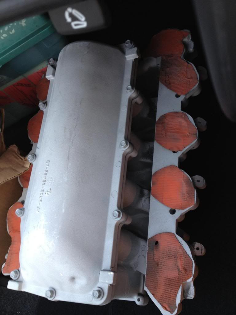

I am starting off with pretty much full bolt on's and a half pi swap. While fun at first i am now bored. So i started buying parts. First up i came across a good deal on a Bullitt intake. Its missing parts, so i am going to be on the hunt. Right now it is spray painted black, and its peeling and cracked. So i plan on having it powder coated Silver. Here is a pick as it sits now.

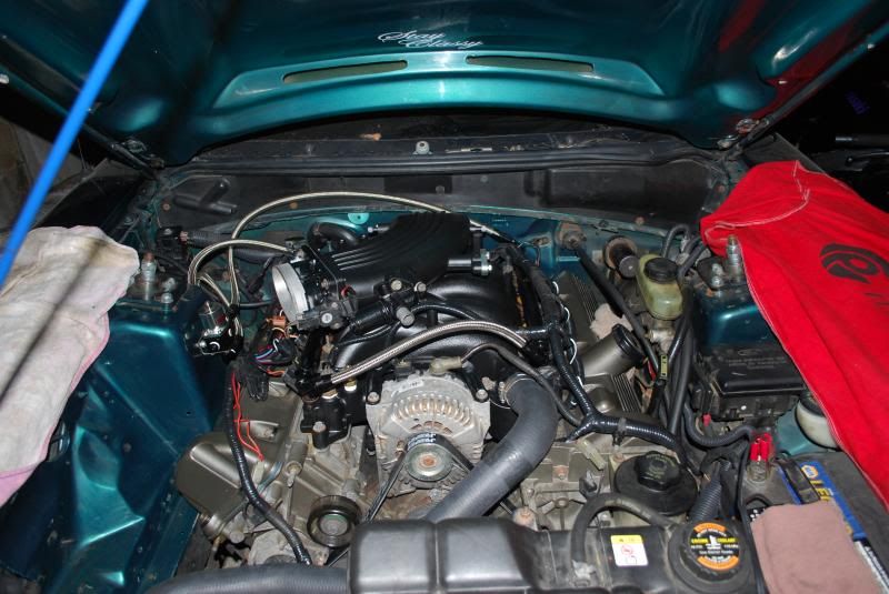

nice build man and good choice on intake. i am very close to finishing my bullitt intake manifold swap. had it powder coated satin black and used MMR fuel rails with all braided lines. so i could probably answer questions for you if you need help with the bullitt. also have pi heads on mine already.
good luck to ya and will be poking back to check the progress
quick teaser shot of what it could look like for ya

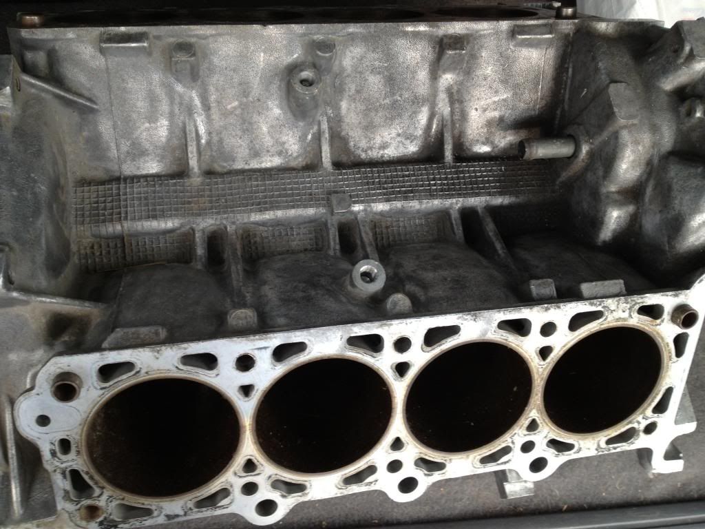

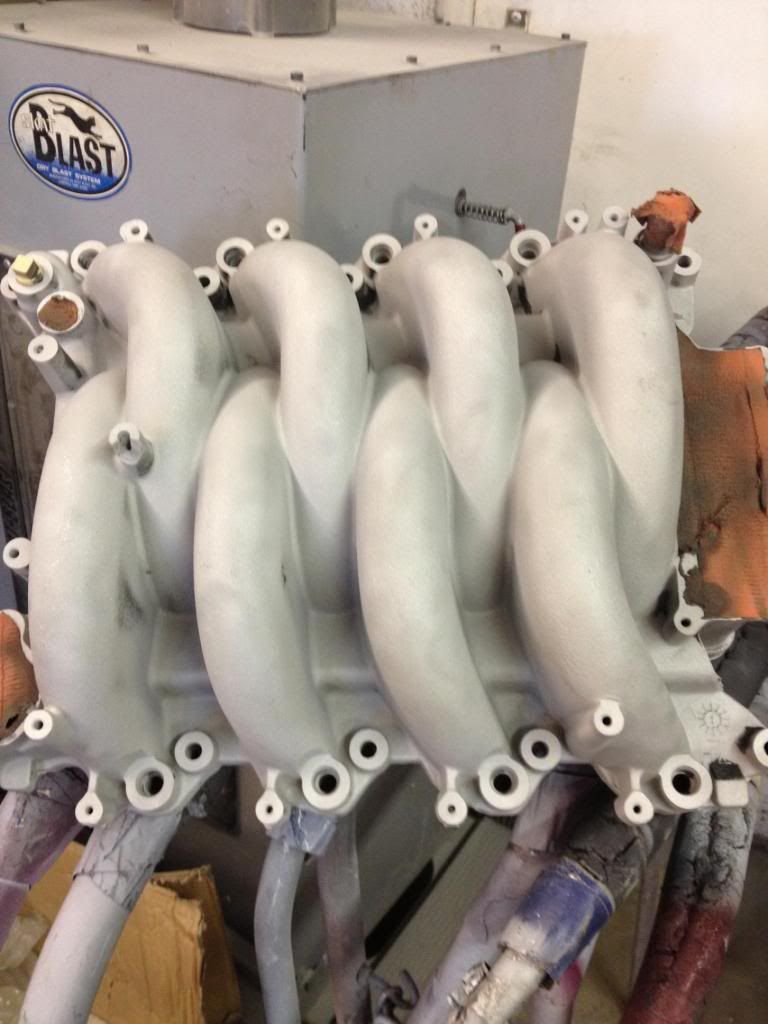

Well the intake is getting sandblasted so i should have that back soon to get powdercoated. Been trying to figure out what direction i wanted to go with the car and decided that i want all motor. So i bought this lil baby.
Bare teksid was pulled from a 98 cobra with 80,000 on the clock. bought a 6 bolt crank to match up to my fly wheel. And il be looking for stock rods and pistons out of a 4v. That should shoot my compression up to about 11.8-1. I want (and need) to run pump gas. So i will be using a little thicker gasket for the heads to bring it down to around 11.4-11.5-1. Hoping that i wont run into any issues with that compression. Everything i have read so far says thats as high as you want to go on pump gas. I will be running 93 because its at pretty much every other gas station around here. Anyone on here thats good at figuring out static compression let me know what il be at with those cams and il make sure i give u rapes. Thats it for now till my next parts come in the mail:naughty:

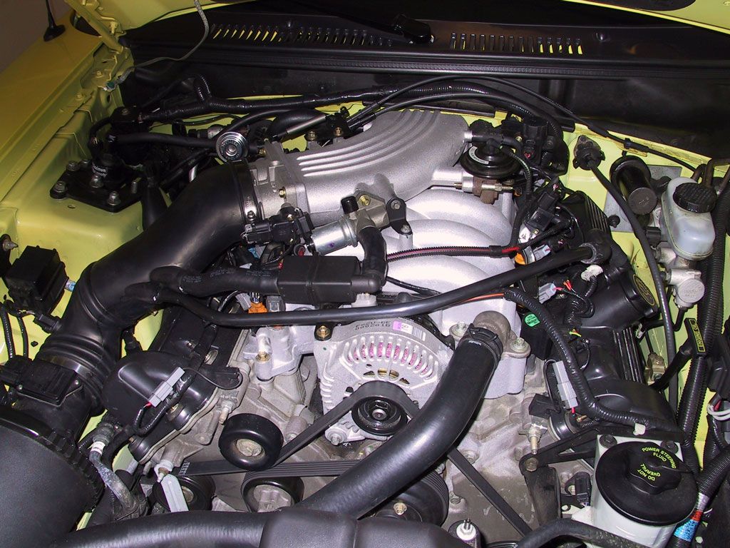

Yea i was also thinking of that because i havent seen one that color. il dig for pics and see what i can fine. And yes i just saw your thread man, comments in there.

Yes im working on finding another set of valve covers and i will be sanding the ridges off and painting them. And no problem, i probably will start ording the gaskets the beginning of the winter. Still have to buy heads, and have the heads and block checked out. I also looked into porting the intake, the only people that i saw gains were F/I applications. Not sure if that changes your mind on the matter.
