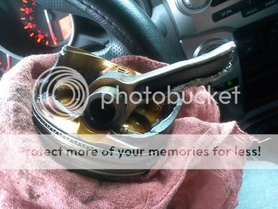

and just two weeks ago I did this

How did you blow it up? Sounds very unlikely on a V1 at 8psi unless the tune was bad.

It made. 340whp in a auto. I don't know how it blew lol. My guess is rod fail on the compression stroke. Number one and three piston failed. #3 was in a million peaces. I wtas not running lean. I was doing a 70 to 90 pull on the freeway it was 60° out. First pull she was getting it lol 2nd pull blew once it hit 90mph I was not watching my rpms at the time so I don't know what it was at. But it could have overreved.

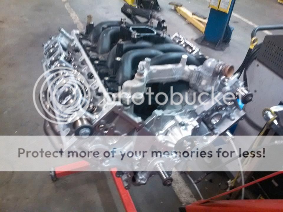

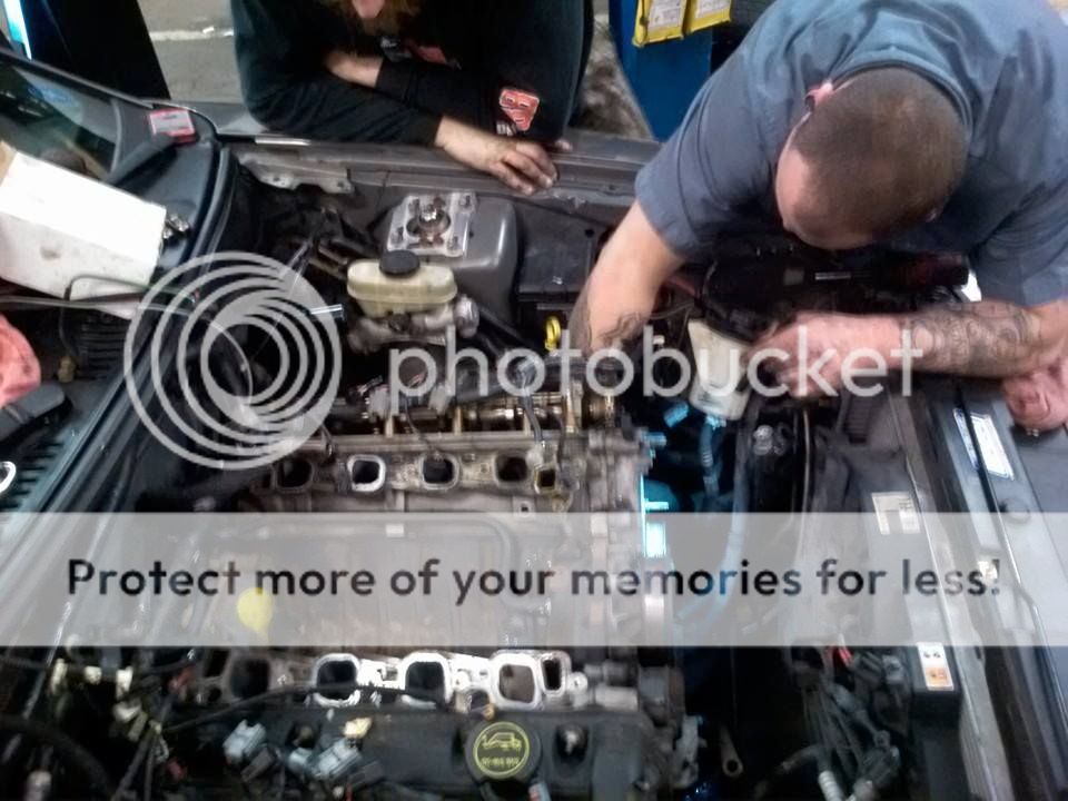

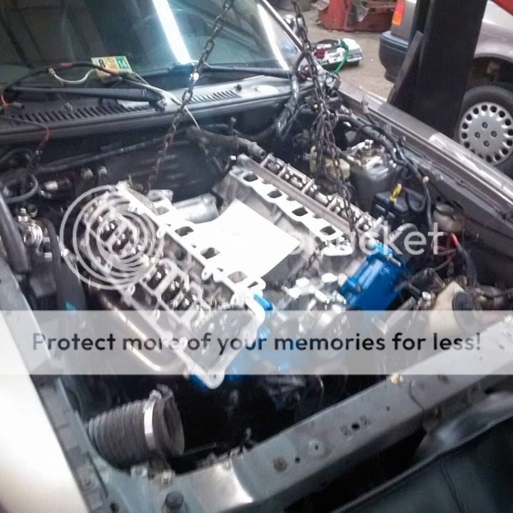

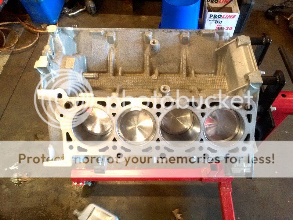

so here is some of the pics of the motor and it getting put back in the car.
48hr build
the last pic is kind of sucks but hey you all get the point lol. ill try to have my wife take some good picks for me.
