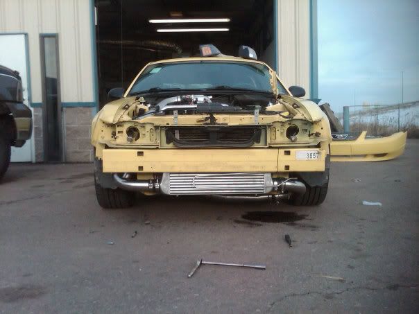

Got my car running today. took it out on 5 psi with my old tune with stock maf and injectors (19lbs) normal driving conditions a/f ratio is pretty good around 14-15 so i decided to dip into the throttle a little turbo starts spooling af goes to 13.2 i keep going holds 13.2 hit 5 psi and still going strong a 13.2 :) Cams and gears def hurting me no reall boost till 3500. Turbo is loud! Im used to my audi and i can barely hear the spool on that so this is a big difference. Overall i have one exhaust leak and the rest is looking gravy.

That turbo should be good for 550-600rwhp. Your tuner can retard timing quite a bit to get more heat to the turbine so that it will spool quicker.
