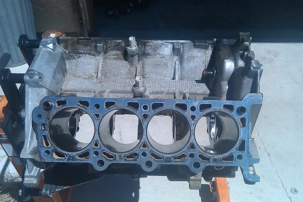

Well got the headers put on today and looks like next weekend she should be going in!!! Then we will see if i did my first rebuild right.
Good luck! That thing looks awesome. Let me know how well it slips in with the headers attached. Or I'll tell you. Whichever one of us puts ours in first. :eek:

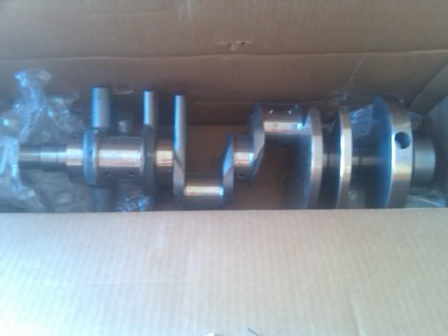

No Its the b head cobra. it makes roughly 270 whp stock, also all you need to do is swap the intake cams. On both sides and its good for 10whp at the least. Only differences from a mark 8 motor is gonna be
crank (cobra ones are forged)
intake cams
intake manifold.
Everything else is the same compression is a tad higher on the mark 8 but not enought to notice it.
