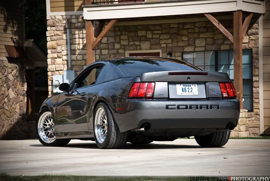

Hi everyone, I made a decision on which wheels I would get for my GT. I decided on some CCW Classics. 18 x 9.5 front wrapped in 265/35/18's, and 18 x 11 in the rear wrapped in some 335/30/18's. Anyways my question was what offset and backspacing should I order these wheels in? So they look just perfect on the car. Here's a few pic's of what I am looking for.

Your VERY likely gonna have issues with those sizes on your car :(
First off, a 335 is too large for proper fit on an 11" wheel and just a waste of width. You would need to do some pretty serious fender rolling on both ends and will need probably need some rack limiters on the steering.

why are you asking us what offset to use lol....ask ccw im sure they can tell you...and a 335 is perfect on a 11in wheel....thats what im going to run on my wheels...an also going to run a 265/40 up front..
:no
A 335 is NOT perfect for an 11" wheel, it requires a 12" in nearly all cases (a couple exceptions)
Jazzer :)

Hey thats Tsprinks buddies car! Trevor Sprinks the one with that fast ass silver gt with just cams and bolt ons that wheel all love that runs low 12s, actually the owner of that cobra is a member here, but i cant remember his name, and not sure if he post on here anymore....
