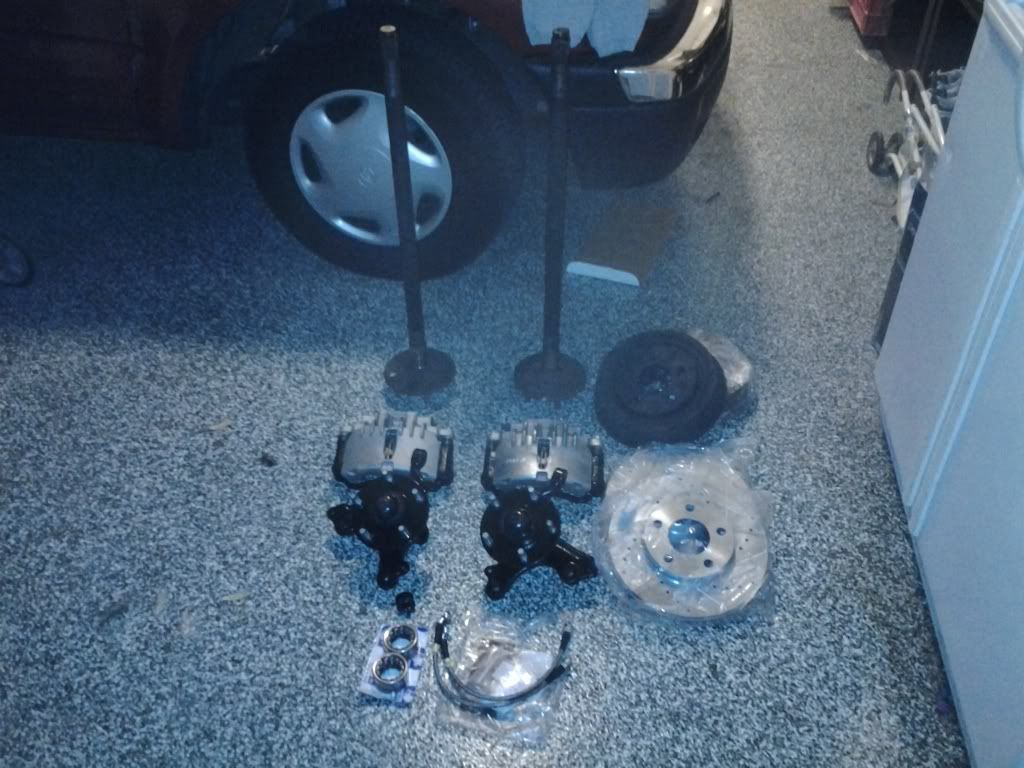

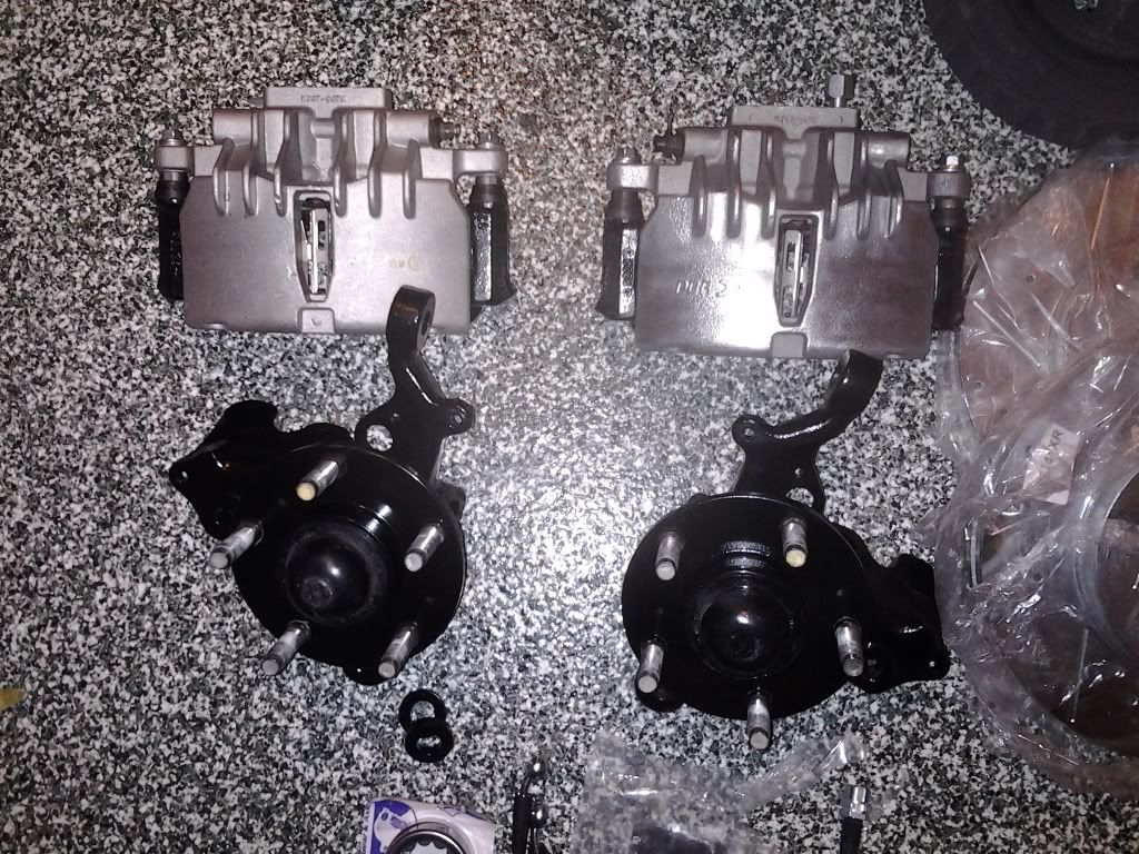

Heres a pile of parts for my 5 lug conversion
1995 sn spindles
1999-2004 dual piston calipers

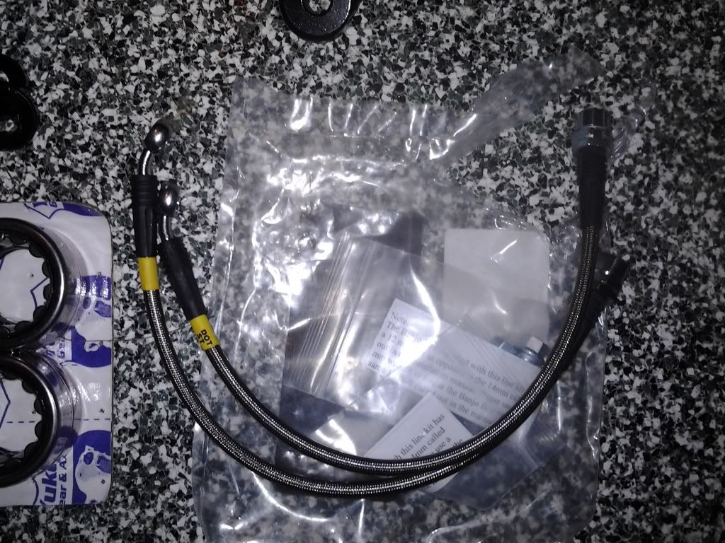

SS maximum motorsports brake lines
Not in pics.....front brake pads
Ranger axles 29 3/16" to 29 5/32" in length
Ranger drums
Rear-wheel bearings and seal
Front rotors
Ball joint spacers
1/2" hubcentric wheel spacers from maximum motorsports, for use with weld wheels in the front ( not in pictures)
2 1/2" long wheel studs for the front, because im using the wheel spacers ( not in pictures)
Here are some links to my other threads cuz i was having a few issues as youll see, when you get farther into this thread

Ball joint spacers... you only need two, so ignore the others in the picture

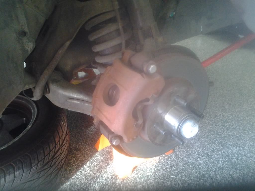

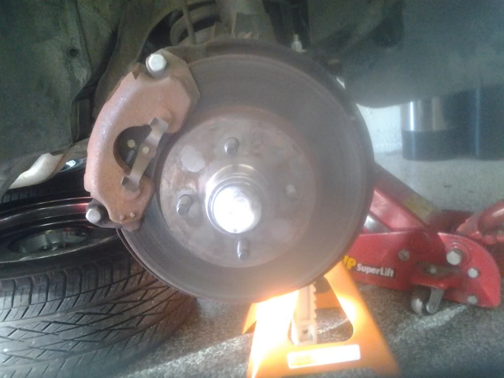

Stock set up.....the point of these two pics is just to show before and after pics

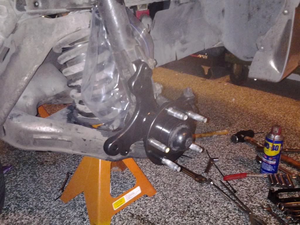

After getting the stock crap off

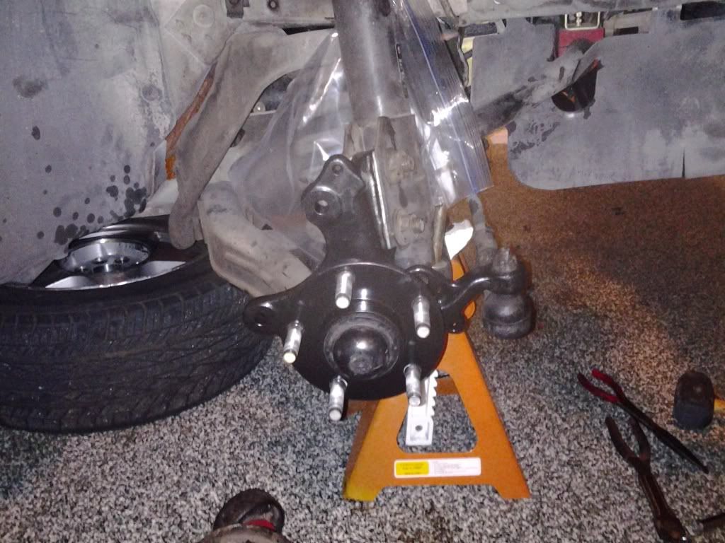

Sn spindle installed

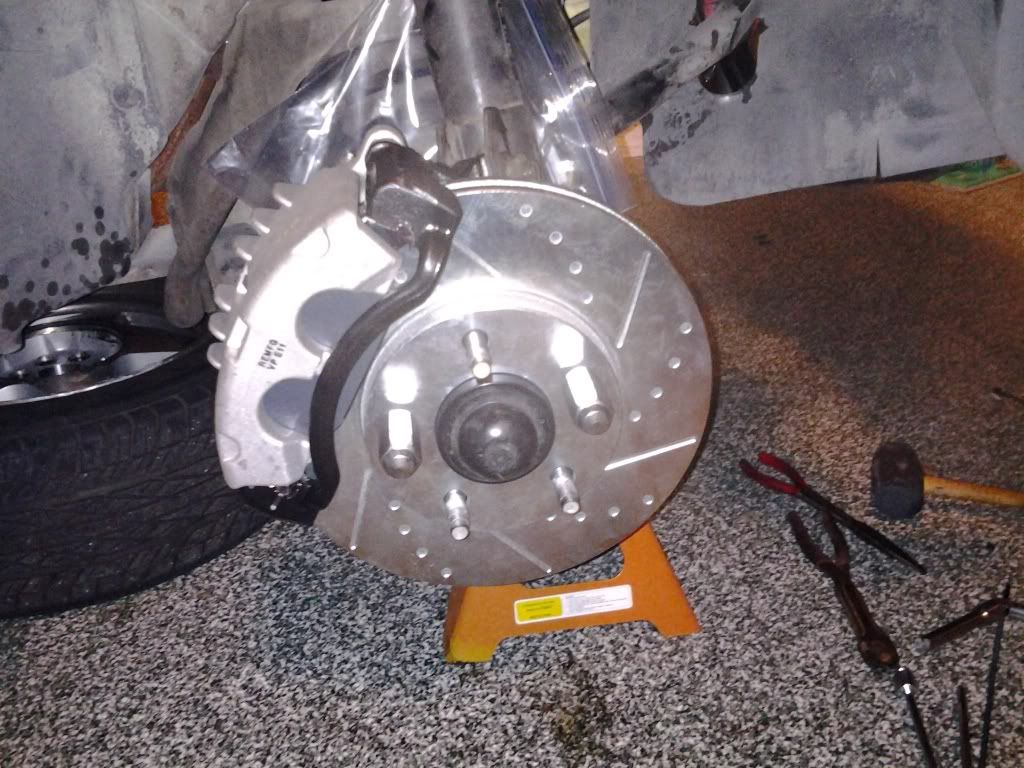

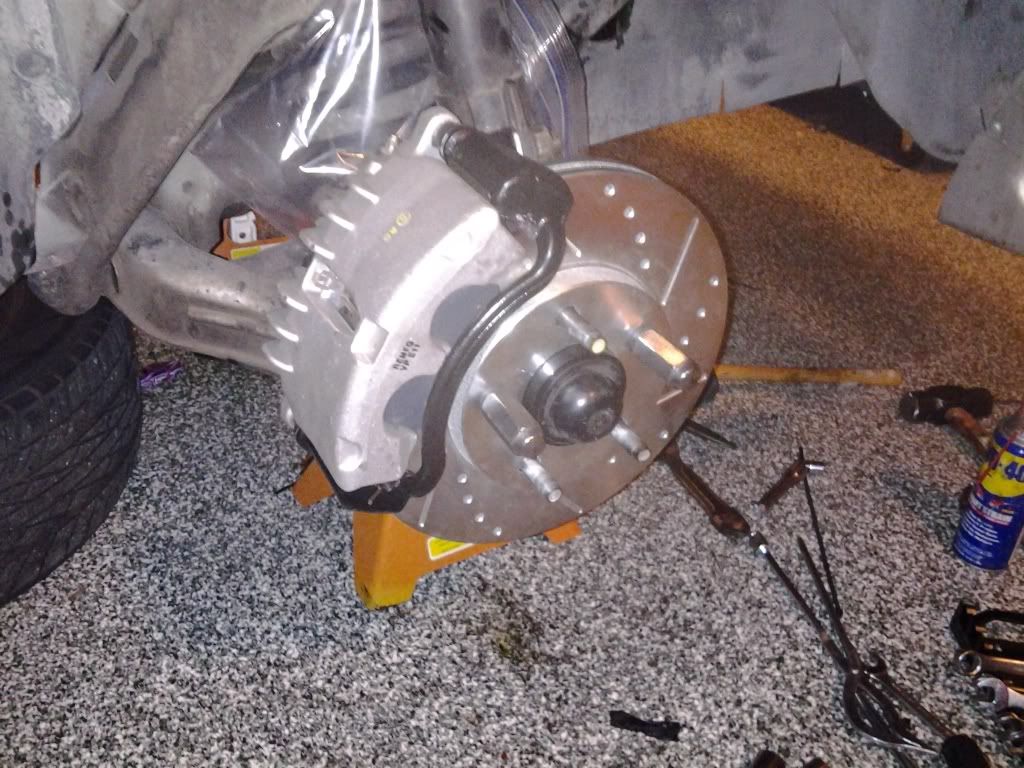

Sn spindle,rotor,caliper, pads,and brake lines installed

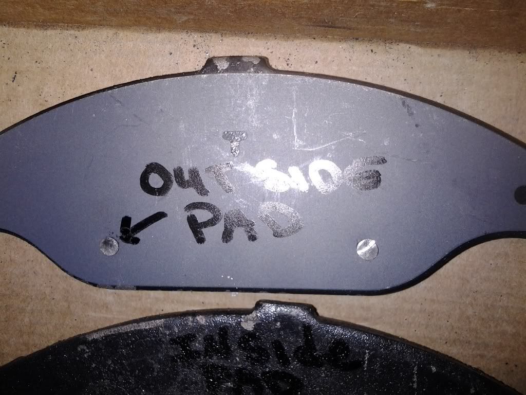

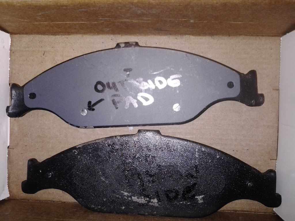

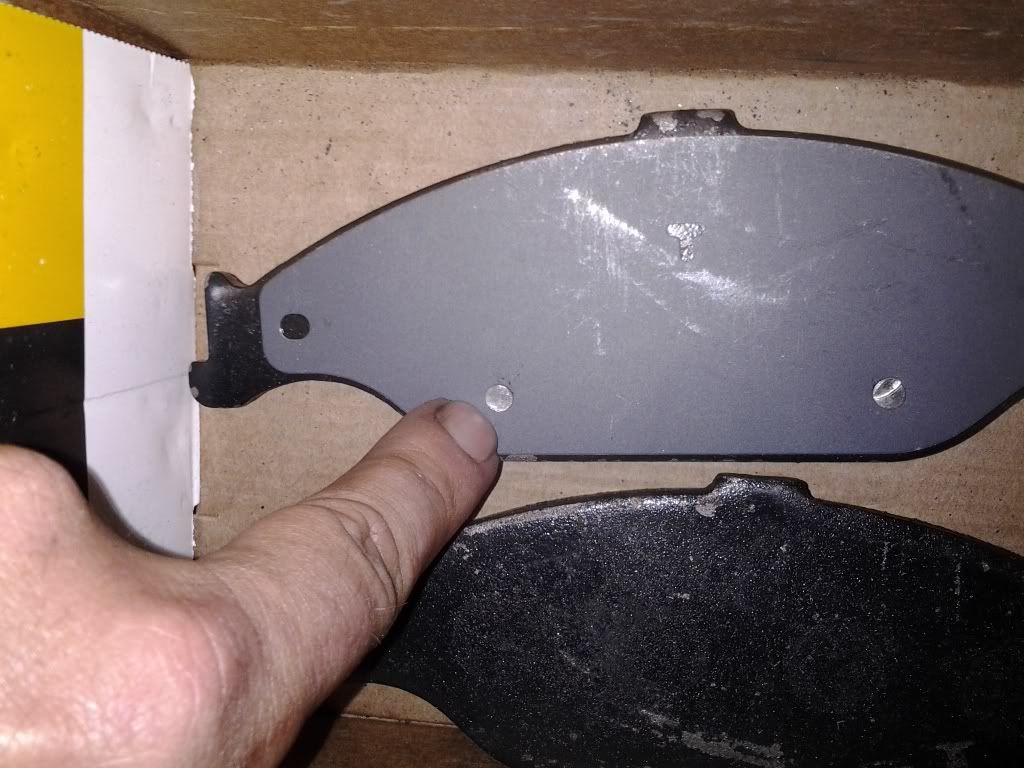

I did want to point out that on the brake pads for the dual piston calipers.... there is an inner and outer pad. If you put the outter one up against the pistons... You Will Screw Up Your Pistons.
I know this because when i first bought my calipers off ebay, i found that each piston on both calipers had a dip in them and the edge was cracked. I had know idea why they were all damaged in the same spot, until i bought the new pads. And the rivets in the outter pad lined right up with the damaged area.
I wanted to make that clear, because the pads are shaped the same and i can see how some one could make that mistake

And just so every one know. If you ever get your calipers mixed up and you cant tell the difference between the driver and passenger side.......... the bleeder screw all ways faces up, and will be at the highest point on the caliper.
So if you install your calipers and bleeder screw in pointing at the ground. You Have Them On The Wrong Side.....
