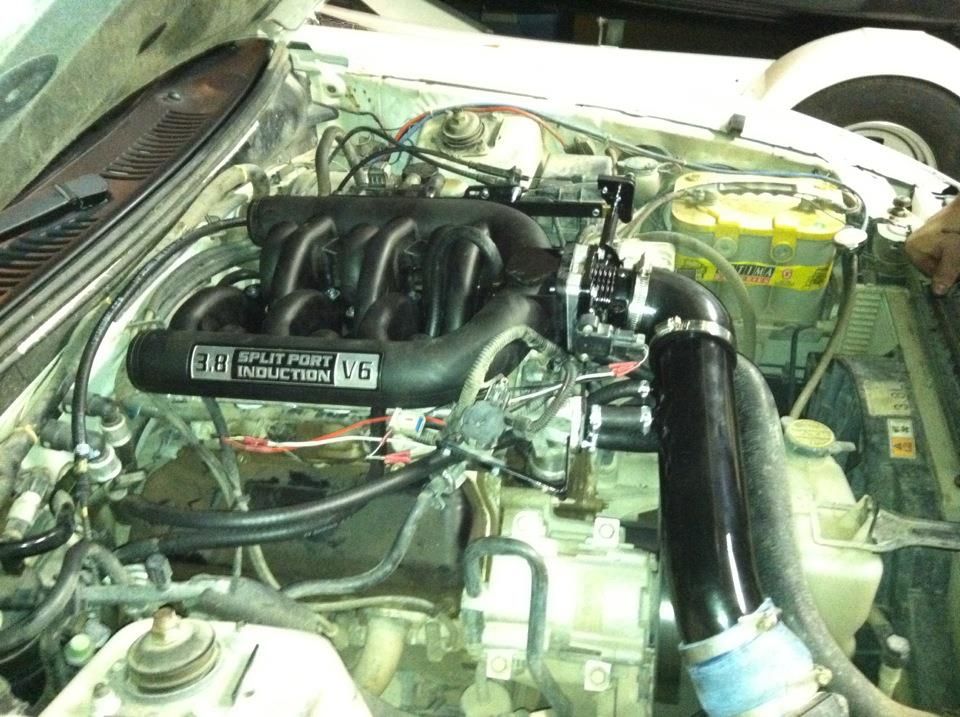

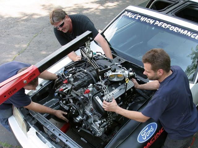

so i am starting to think about long term goals for the stang. i currently have a fake saleen aka the "faleen" given by the great Cheeks McDuke with a 3.8 v6 windstar motor. i have the opportunity to buy a 4.6 gt motor with wiring for dirt cheap. motor has 90,000 miles on it. i really need your help mustang brothers with this direction in my future. I am a high school shop teacher with a limited budget but im thinking if i buy the motor and sit it on a stand for a year while i put it together with cams, heads, p/p intake, upgraded fuel system then i can drop it in around a year. this car is my daily driver but i got the mod bug REALLY BAD!!
ok here is my question....
buy 4.6 and build it
or
v6 m112 setup
im thinking they will cost the same, maybe im wrong. let me know what you guys think
just some fun photos.....
4.6 with twin screw:
my power house:

pretty sure that first pic is a 5.4, anyways

Also pretty sure that is an Eaton and not a twin screw.
And if he didn't know that I doubt any swap is going to ever happen!

i knew it!!!! :mad: I KNEW IT!!!! you flaming mother truckers focus on the pictures and not the thread...... thanks:facepalm: stop hating and offer some ligit help. i pulled the first pic off google so you wouldn't be bored looking at this thread. haters gona hate..... to ESG-642T, screw you or eaton you what ever you like better, thanks for your insightful uplifting help. :bash:
