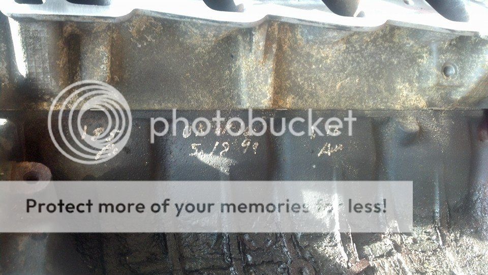

also got a look at the rear main seal, to me it looks nice and dry, I assume when they did the clutch they also did the rear main seal. The oil/grease all around it I believe to be from the oil pan gasket because my god that **** is everywhere around the bottom of the motor. I also found a date sticker on the back of the driver side valve cover, its a few days off from the date written in the V of the block, surprised its in such great shape!
